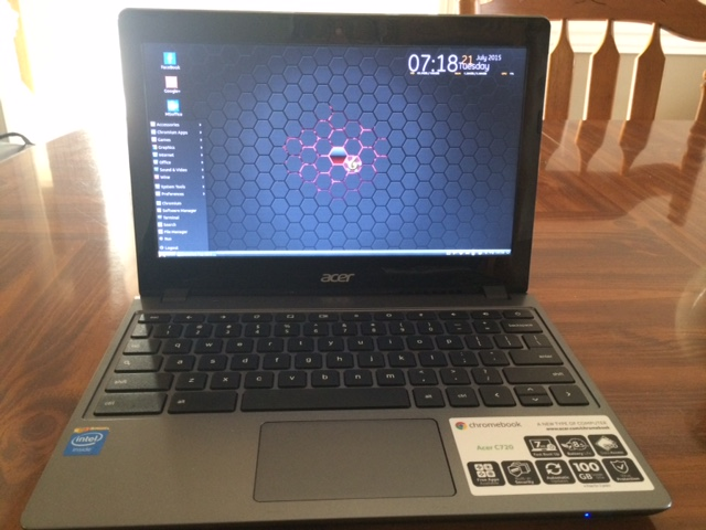

The nice thing is I didn't have to struggle to get anything working so far. Other distros have an issue with the trackpad, requiring debugging. Not so with Peppermint. Trackpad and everything else seems to work just fine.
I even installed Steam and am able to play most games, even Xcom Enemy Unknown.
Ice is working fine, Kodi, Geary, Chrome, Gthumb, Banshee, VLC.
Here is a screenshot:
